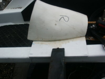

I have been looking at the japanese style foot holds for the x2's .I priced them and they are wayyyyyyyyy out there,so that being said I am working on making a set.Here is where I am at so far.I am using the pvc foam product from Farco plastics,it is thermoformable so the first step is I cut out the pieces and heat them up to 150 degrees for a few minutes.Then I formed it around my shoe while it was warm and hold it till it cools,it only takes a minute to cool and retain shape.Then I spread it out slightly before it fully cools off.
Here is what I ended up with.

Okay one side is done,for anyone wondering this is going to be a mold,It is simply just glued with epoxy at the moment.I will glass it on both sides for strength,gelcoat it then use it to lay up parts on instead of making a reverse mold and pulling the parts that way,if I did it the other way this would just be a plug. The pics should hopefully fill in the blanks.

My thinking is you can either put your foot in them or put your foot in front and use them kinda like a wedge on a stand up.I also want to make them easily removable,I am still working on that part,maybe using wingnuts like they use on wakeboard boots.:fing02:

Crab truefully these look like they would be easier to get out of than a lot of footholds I see mounted on standups,I'm all about flatwater anyway and plan to make these easily removable,more on that later,now I know what the jap versions cost they are ridiculous,I was thinking maybe $80.00 a set for a fiberglass-white gelcoated set,$125.00 for a carbon fiber set,let me know if I am in the ballpark or not.

I'll try an $80 set. If they work well I will get a carbon set for the 780. I was planning on raising them slightly with the mounts that I have in mind, to make sure there easy to escape from when you have to toss the ski 8feet in the air. They dont look any harder to escape from then the dakine straps I was using on my old hull.
