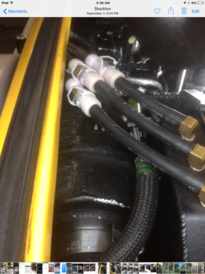

We run a RRP pipe and water box with a 2 piece hose with a couple bends. It raises the exhaust hose up well above the water line while floating. Works great, never had a problem and we ride/float/talk/rest/ride/float/talk/rest etc. a lot in rough water. Not surf, but rough lake water, never any issues.
