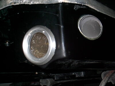

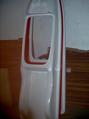

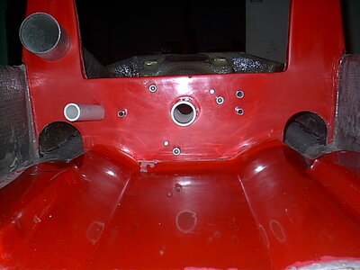

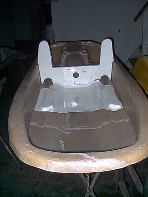

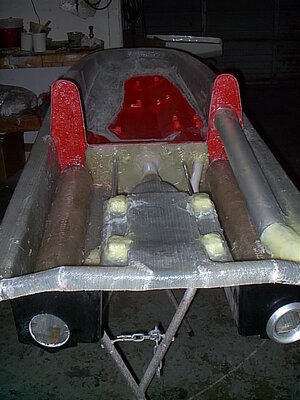

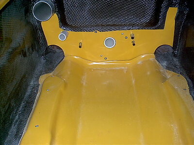

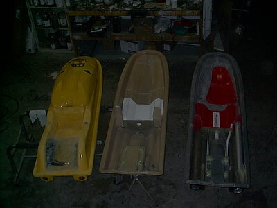

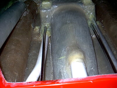

Due to popular demand here are some pics inside "The Factory"
-these hulls are layed up with 1208 bi-axial mat and vinyl ester resin. Cooling lines are SS. Exhaust is thin wall aluminium made by x-metal.

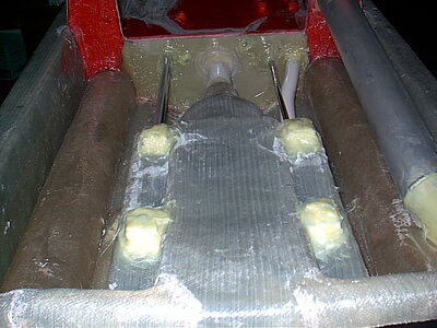

more!

:bigeyes: That is some purdy stuff right dur. Damn:biggthumpup: How do you get the bilge area so smooth and shiny in color. Thats friggin hot.
Chick you suck, you lucky bastard.
sjetrider
615 Freeriders are addicted to T1 madness.
Oh, I see now, its part of bulkhead and molded as a seperate pc. sweet and hot looking idea. I never noticed that on your stuff before.:biggthumpup:

i like that exhaust outlet setup you have going there. with the dual scuppers your limited and ive never been a fan of the front exhaust because it makes a mess of the ski from that point on... nice work

Have you had any problems with the bedplate seperating from the hull? What do you use to keep it in place.
sweet pics WaterfreaK!!!! Killer hulls... how much does the top and bottum weigh seperately??????? and how much does it differ from stock? please.
