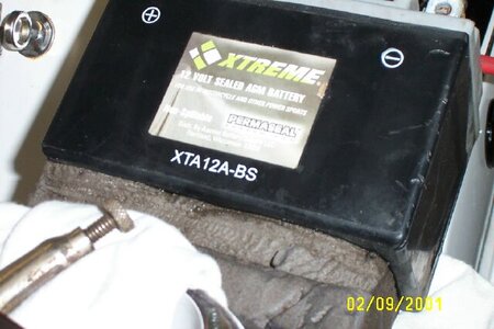

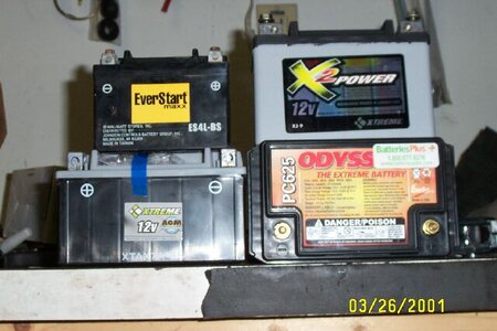

how many Ah are they?
here's a few I have tried....Love the 'Xtreme' brand.....they are about 7lbs, 12Ah and seem to work very well..
the last one I had lasted 1.5 years and RARELY needed a charge...only had to replace it because the terminal got broken by someone with ape fingers
