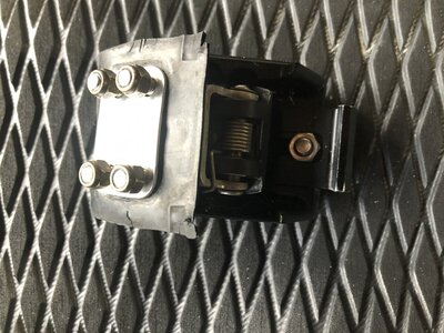

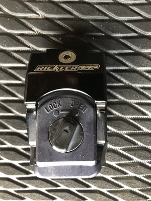

Have an oem mechanism with a RRP latch and a Billet keeper in good condition for sale?
$65 shipped Sold!

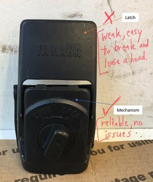

Have never broke an oem mechanism, but definitely bent them up! Cast oem latch break all the time.
Oem mechanisms work fine, but as stated above, have sloppy clearances. The full RRP latch assm is a very nice part, but pricy @ $200.
What part breaks? I'm super paranoid about loosing hood and sinking ski, so...interested.
The top bit is what breaks for me every time. Shears in half on one side or the other. I kept the OEM bit that mounts to hull, just replaced the OEM latch itself with RRP. Seems to be a rock solid combo and way cheaper. $75 from @JetManiac iirc.
Edit - Seeing the pictures above, the LATCH is what breaks for me, although i have had to bend in the locking bar on the mechanism so it would stay locked during hard impacts. Breaking so many latches was a combination of my hood being loose due to older hood seal / worn out xscream hood hook and eating poop on 10' high roll attempts. Lot of side impacts and flexing in hull. RRP let me adjust so hood is tight now, and I land most my rolls now lol.

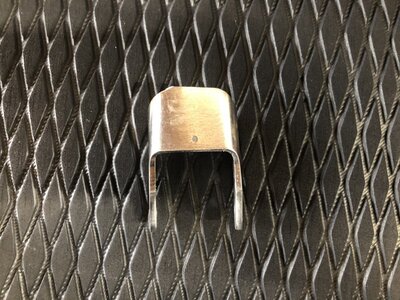

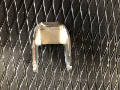

I have an x- metal SS latch also used. Some slight grinding done on hook , im guessing for better fit in keeper?
$40 shipped?
