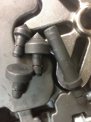

Yes, the harmonic dampener pullers come with different size ends that go in the tip of the forcing screw, which is what contacts the crank snout. Usually large and small tappered tips and a straight one that like a pin maybe 5/8ths. Normally use the one fits the flywheel hole and crank about the best.. I can post a pic tonight...
Anyways, with it all installed and forcing screw cranked down, but not to the point it malls the crank, hit the nut end of the forcing screw with a large hammer and it shocks the flywheel off...

Ok. Gotcha. My puller is missing all the tips so I had to use an old socket that was the same size as the flywheel center hole. I guess it's time to buy another one. I will definitely try that trick next time. I never had a problem with pulling Yamaha flywheels so this kind of had me stumped.
