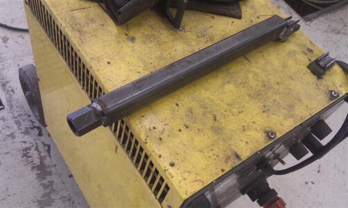

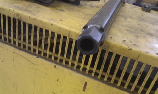

I don't know if this is going to make sense.
if your holding the impeller tool in the vise and wrenching on the spline tool hanging out of the vise on the end of the shaft isn't it still left loosy - righty tighty.
if your holding the drive shaft spline tool in the vise and wrenching on the impeller its left tighty -righty loose.
I've seen a # of people be told its a left handed thread and not understand exactly what to do. good luck with getting it off.
