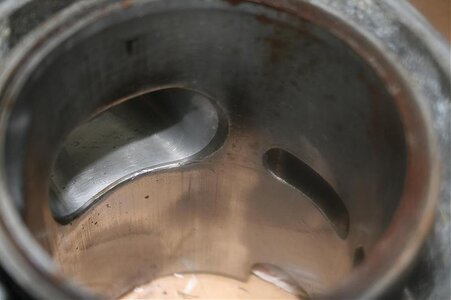

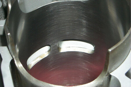

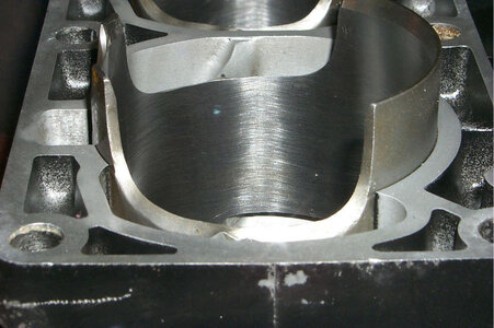

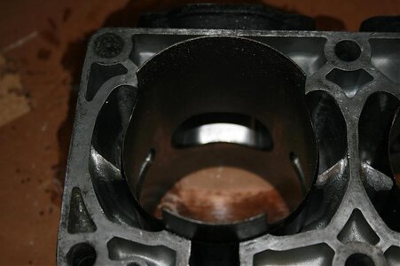

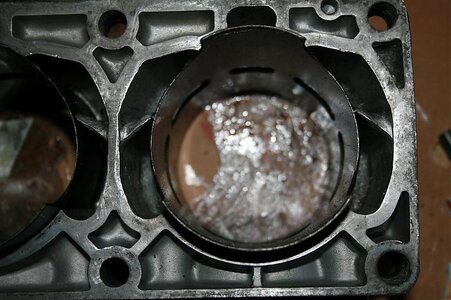

here are some fuzzy pics to look over...
I guess you can see the way the bottom of the transfers are worked with these. if you want better pics of the ports I'll take more. any other pics you want?

Tim, get the exhaust port, looking from the top. Also, I'd be interested in getting the main transfer and secondary transfer together in one pic (to see how far apart they are or if they are stock size)

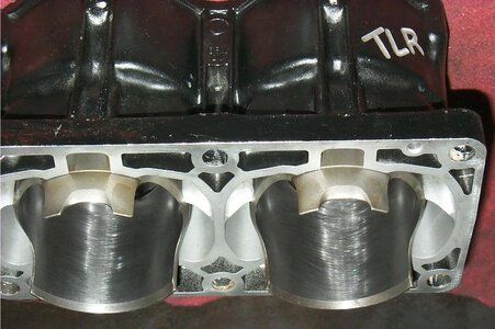

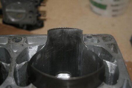

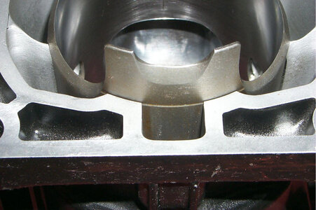

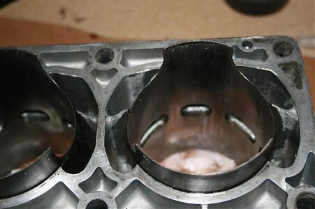

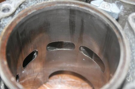

i got my head out of my ass and took some better pics.

i've got some calipers, do you want some measure downs from the top of the deck? suggestions for the widths. I guess I could do a rubbing and draw it up in cadd with dimentions.
at that point it's just begging to be plotted out on vinyl....

Naw....I seriously doubt anyone touched to exhaust port roof. The tops and bottoms of the transfers look relatively unscathed, too.
It's a mild freestyle port. Ought to perform nicely.

Tim, that cylinder looks good but the sleeves are super thin.
Are you going to hone it or have it re-sleeved?

so you think they're just widend? the angled the bottom of the transfer runner and trimmed the bottom of the width of the cylinder on the intake side.

I meant that the exhaust is widened, not heightened. I doubt anyone would do that, especially on the T cylinder.
The transfer tunnel divider is a bit angled, correct. If you look at the pics #0 posted, you'll see that it's also angled there, but it's more recessed into the cylinder. Also, the sleeve is shortened right there (4 areas total)
Very similar to yours, but a bit more of each. I think the transfers on #0 are a bit wider than yours, but I wouldn't bet money on it without measuring.
Btw, each of the points I addressed can be taken care of by yourself purdy easily.
Oh, and the sleeves (intake side) are shortened to get a bit less obstruction in the intake runner of the cases.
However, that is there for a reason - it deflects air/fuel charge up the boost port as the piston goes up (reverse of transfer ports)
There's a trade off - you want boost charge, but unfortunately the sleeve obstructs the intake in the process.
Slightly shortening it, as in your cyl, is a good compromise.

also, at the bottom of the boost port the back side is slightly buged out. all of the port runners have grinding marks the entire length of them so I guess they'be been opened up a little.
