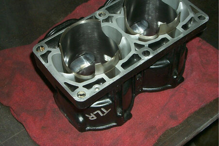

I"m willing to share my porting with you guys...
Mine hits very hard. it's like a switch.
it's a 61x/760 combo. it's currently disassembled so it'll be no prob to get some measurements and pics.
Wow!.... I would like to see some of those pictures Tim.
