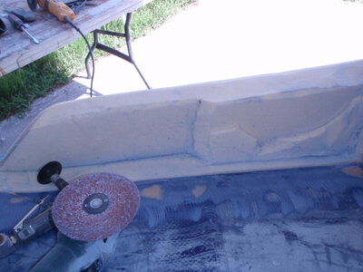

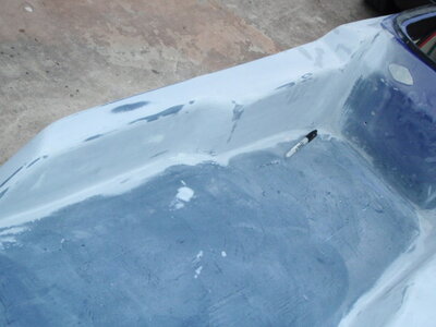

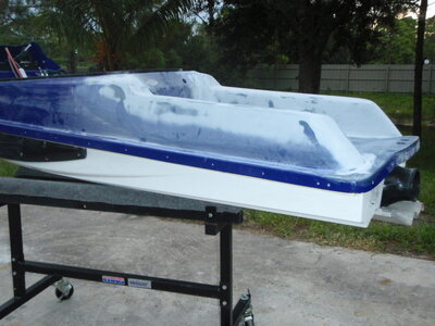

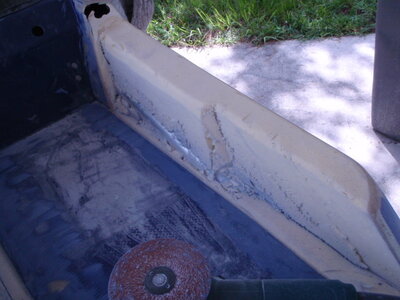

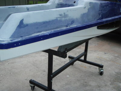

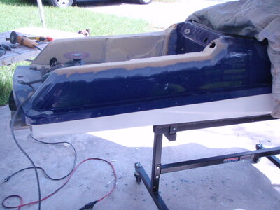

This is a project i am working on for godoco . lowered the tray and widend the back 4 inches and the front 2 inches so we didnt have too redo the exhaust routing . This is for a race application to give it more a feel like the hydrospace tray area .

cool I have always wanted to lower the sides a bit but just too lazy err busy to take that on. be like an sxr size tray on an sj. lots of real estate.

wow looks better than i thought it would.
i bet it will look really nice all cleaned up and painted.
I am doing something like this very similar. My gunwales are about 1 1/4" wide, and I am making them like the SXR rails and the highest point of the gunwale will most likely be about 2" lower then the stock height for the yamaha gunwales. looks great though!

Yes, it is an 08 SJ. When I rode a 08 SJ, I loved the ski..... hated the tray. Even after riding SJs for 15 years, once I got used to riding the SXR and the Hydro with their HUGE trays, I felt like me feet were tied together in the SJ hull. I think Lee's ski is going to be awesome.

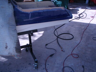

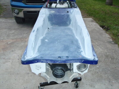

here is the after glassing picks getting ready for paint tomarrow .
