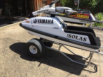

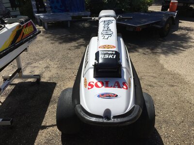

Ready for water test. Came out decent for rushing everything but glass work. Butchered the side on the turf job so had to copy it on the second side. If I’d actually waiting for paint to cure before flipping it over and working on it would have been pretty good. Will get the job done though B6B717C4-3FD2-4B96-ADAD-86080A0AB00E.jpeg4C1BF58A-A4F2-4D11-924F-F972A9888C20.jpeg

Handles good. Way more cavitation then I’d hoped..don’t remember what they are like for a baseline though.. Has solas 17/23 cutback 2mm and it really spins up after a slide or low speed turn..going to try siliconing pump seal and see if that helps. If not it’s getting a Kawi pump. Hopefully I can get the turf off in one piece.

He said it felt more stable but turned better but we only tested it for a bit..I’m afraid maybe I didn’t get pump pushed up tight enough against shoe when I set the pump inserts. Looked fine but cavitated more than it should have. I sealed it going to try again tomorrow and see. I enjoyed riding it aside from the cavitation. Think the wide rails made it easy to ride. Should be good for him

The guy I bought it from made the rails both wider and deeper. Think it was a mold of a fx based hull tom21 made..he cut the vertical part of the old rails off and glassed new ones over what was left..I’ll take some better pics of the side you can get a better idea.

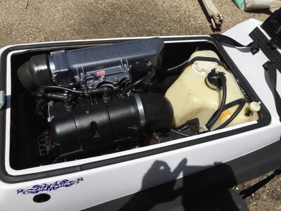

So final parts list for anyone interested is
62t/62t with stock 61x pipe, timing advanced and 760head gasket
Stock length pre 08 sj pole/steering cable and bracket moved the ball in and ground the sides of nozzle. Turns until it hits side of pump tunnel
Will probably get a lowered pole bracket for it
Wamiltons -1 turnplate on umi steering and 4deg umi bars

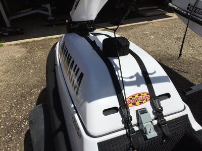

Cold fusion hood hook
Cold fusion throttle
RSKI hood straps. Buckle style but rated for 350lbs each
Cut down stock chinpad
Top air intakes on hood filled
Superjet tank with internal fill
Solas 17-23 cutback 2mm and modified stator section
Stock ride plate
R&D toploader intake grate

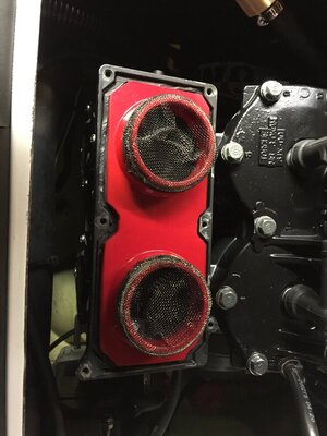

701 industries air box insert that raises intake so water can’t get in
OCD solutions tidy bilge kit and ocd toggle switch hidden behind 26mm padding on dash
Not a bilge pump fan and especially don’t like having to have it next to tank but I didn’t do a one way so it is as reliable as possible. Hate not being able to get all the water out of it though when I wash it. Engine compartment Stays dry as a bone when riding.
Stock hoodliner with Seadoo breather tubes with raised inlets so would have to have allot of water in hood to get into ski..

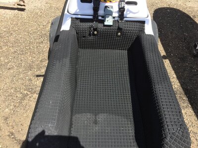

Black waffle hydroturf
26mm padding on bottom of tray and dash..18mm on sides and 9mm on top of gunwales. Super plush and nice. Smooth turf on rails

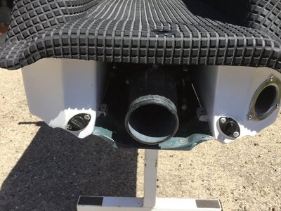

ADA bow eyes/bilge outlets

Should also add the only kid specific things I did to it was pad tray narrower which I actually think is perfect And we are just running just one of the softest Mikuni throttle return springs and the throttle close to the bars.
