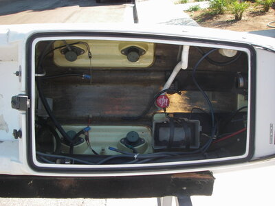

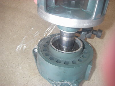

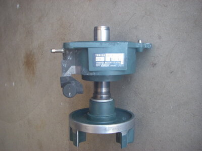

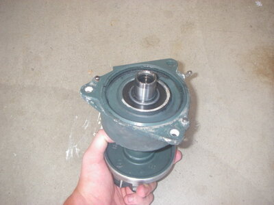

Removed the engine as well as housing bearing, do you approve of my housing JD? I don't know how to remove the bearings or coupler.

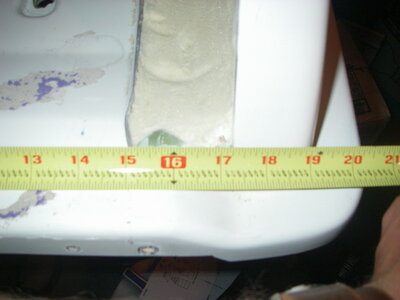

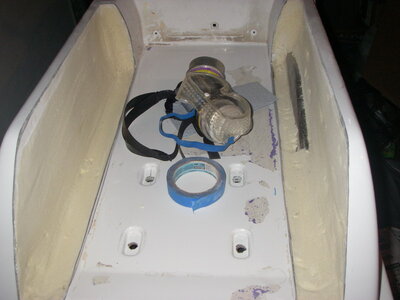

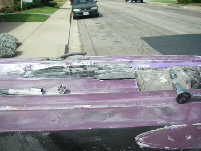

Went from 12" to 17 1/4" wide....Unfortunately, Yamaha did not want me to widen the tray, they placed my pipe pretty high...I will just have to make the most of it....(beating it!!! haha)

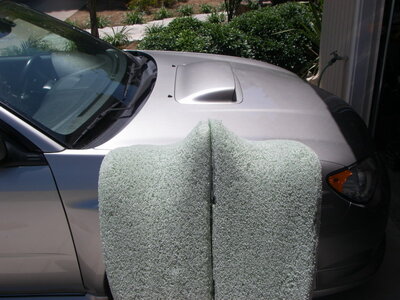

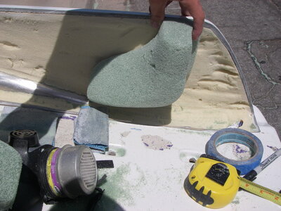

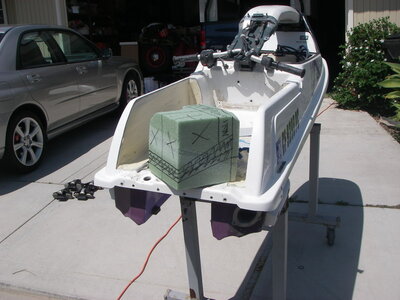

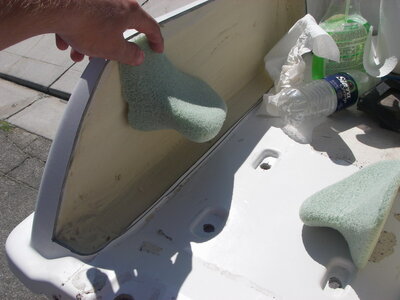

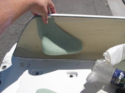

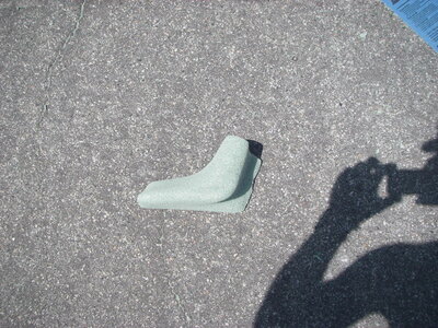

Went to Michael's picked up a 8x8" stirophome cube. I marked up a few lines as guidelines and I began sanding...I left them a little bigger just in case. This is my result.

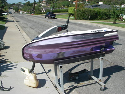

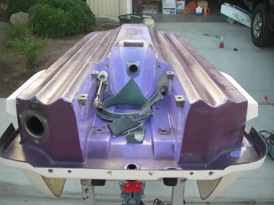

Any thoughts on what grit sand paper I should use for that paint.

Dude........loose those Kawi 550 training wheels! Drill out the rivets and fill the holes before you paint. They didn't do anything for the 550 (and we used to remove them) and they won't do anything for the FX but screw up the handling.

use 80 Grit for the sanding of the hull for paint make sure you do a primer coat then come back and wet sand the primer with 400 Grit after that you will be set to paint bud. This looks like my 550 build but almost worse as far as the carnage of a cut you did for your tray.
This will be interesting to see in the end.
Keep it up bud.
-Mark

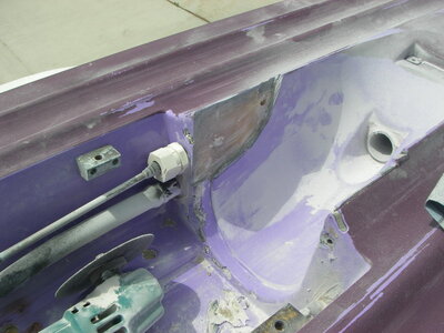

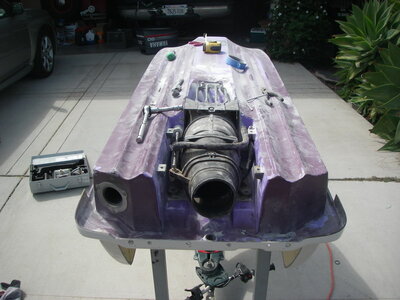

So I would consider today, a good day. JD insisted I take the sponsons off, so there they go! Also cut out the pump shoe area and the bolting area. I cut out a little bit too much in some areas such as bolting area and the pump shoe ring. But its nothing a little fiberglass cant fix. The pump matches up perfectly with the intake grate. I put on the 650 steering nozzle just to see how it would look, x2 nozzle is on the way. Overall I am pretty satisfied with today's work.

Lookin' good. You'll need an X2 tilt/steering noizzle though. It moves the steering pivot back 1" and lets the FX steering cable hook right up. It also gives you trim.
