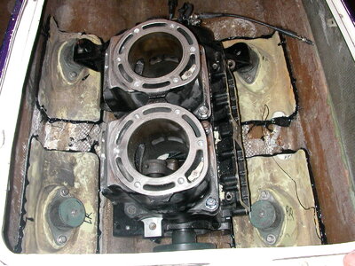

Here are some more pics of the defoaming process we started last Wednesday. Gonna hit it again tomorrow night and get the motor mounts all glued back in. The other pics are Yamahammer's 4x4 (what used to be a Toyota pickup). We had to go hunting so its slowing down the process :biggrin: but we'll be back on it with more pics to come :biggthumpup:

did you cut the mounts out of a donor ski ? as you glued THE MOUNTS on the surface how will you deal with the height difference in reference to the output shaft coupler ?? and what glue did you use ! every thing looks good BTW !

we used a 3m glue that they use to glue doors and body panels on cars...ask bonzia bob what the number is on it i can't remember...good stuff though..maybe it's 8115 two part glue, can't remember...thanks for all the compliments everyone...it makes this project much more enjoyable to work on without all the haters dogging it...more pics to come as the work progresses...
What height difference? Those are the stock FX-1 mounts, we just took them loose, cut them in half, lined everything back up and re-glued everything. Not a problem. :biggthumpup: Here's a pic of the epoxy we used:sneaky:
