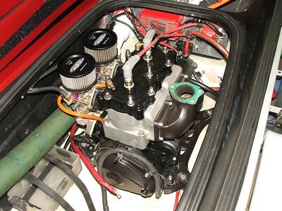

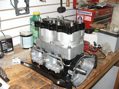

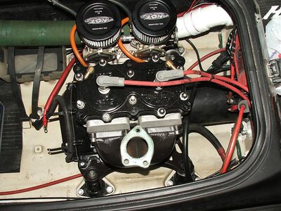

Well, the stroker motor issues are all taken care of. I bolted it in the hull tonight. Now all I need to do is get the total loss all hooked up and get the stupid start stop switch to work. This is fun, right?
