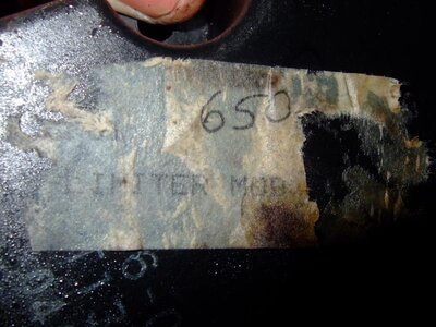

the 6m6 exhaust manifold will not work on a 701 cylinder. match up the gasket and you will see what i am talking about. it will leak water into the exhaust port. it may work for a few rides. trust me it will fail.
really? i ground out my coffmans exhaust mani off a 650 to match a 61x cylinder and it matched up fine. i even stuck my hands into the exhaust port from the top of the 61x cylinder to feel around. seemed fine... what do you mean?
