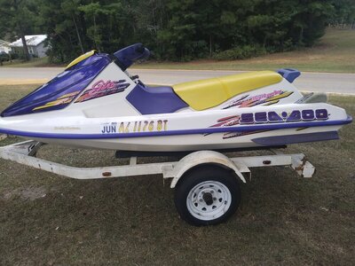

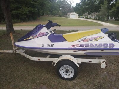

Lets do a quick recap shall we , before and after.

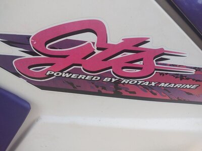

Today we are doing decal touchup , yes you heard that right , decals for this ski are not available , I did find one on Ebay and only one , while I know I can't make them look like new I thought I could make them look better , even if they were available they would be expensive, and if you replace one the rest of them look off , I did some artwork on them with grafitti pens for use on fabric, then I sprayed clear over them to lock the colors in , to me they look much better and good enough for this ski.
The goal here is to make it look good , not perfect it is still a 25 year old ski after all , you just want it to look like it was a well kept 25 year old ski.

The deflector had a really nasty sun baked GTS decal on it, it wasn't coming off and leaving the paint intact , so I sanded it off with 80 grit on the DA , then I hand sanded it with 120 grit , hit it with bonding clear and then a heavy coat of primer.
That baked out in the sun for about four hours , and when I say sun , I mean unrelenting hot a Hades sun , I then wet sanded it down with 400 , then 600 and sprayed it with Rustoleum 2X Ginger Yellow.
There was not going to be any matching the purple on this hood , at least not for a reasonable amount of money , since I am accentuating the yellow on this ski anyway , I just painted it yellow , I had a decal in the kit I bought with the large Seadoo decals that fit the deflector really well so I used it here.
I like Rustoleum , this 2x says extreme gloss and they didn't disappoint in the least , I do have to say for a quickie spray bomb paint job it turned out pretty amazing.

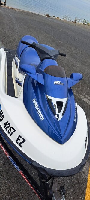

Myself
manic mechanic
Twin Lakes AR
I bought this 4 stroke '02 GTX off one of my customers . Her son-in-law had jump started it and blew up all the electronics. It was on a single trailer that I sold. Then recently I bought another one EXACTLY like this off another customer with a bad engine WITH a trailer. It had all the electronics I needed. I sold it today for $3000 and cleared some profit. Could have made another 1k but didn't want to sit on it 'til next summer.
