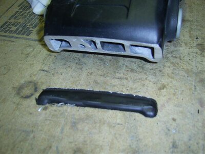

First I cut about 1/4" off the bottom tip of the pole. Placed in a chop saw squared up makes a nice clean cut.

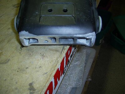

After that was removed you need to grind a little off the corners. Rounding the corners help to match the contour of the factory pole bracket.

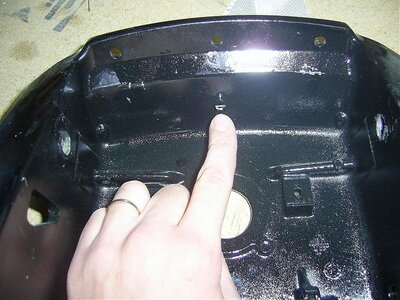

Inside the stock pole bracket there is a nub that needs to be ground down so the RN pole can have full movement all the way up. Before grinding

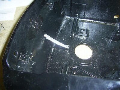

After grinding
