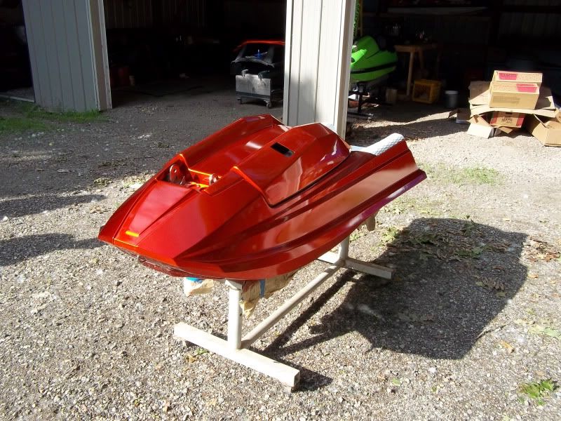

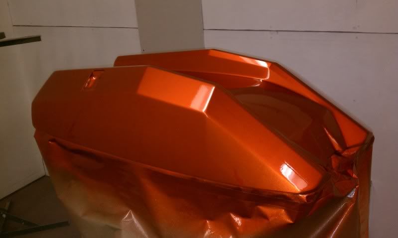

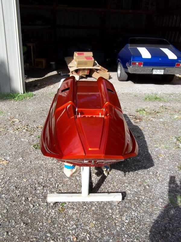

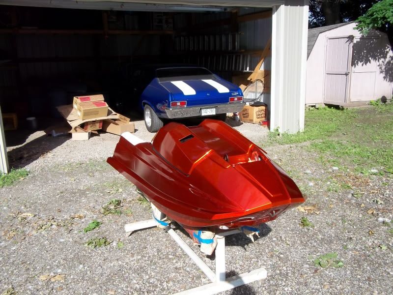

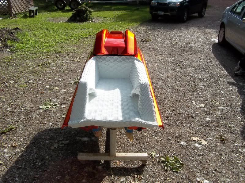

Any teasers on paint schemes?
well the paint was suppose to be there the same day I dropped the skiis off...didn't happen. Looks like I can't win with :):):):) being on time when it comes to this build.
They look awsome! Primarily surf or flat...? What made you go with a trinity hull over all the others, just curious?
They are for lake riding, but we do get some massive boats and MASSIVE double ups...

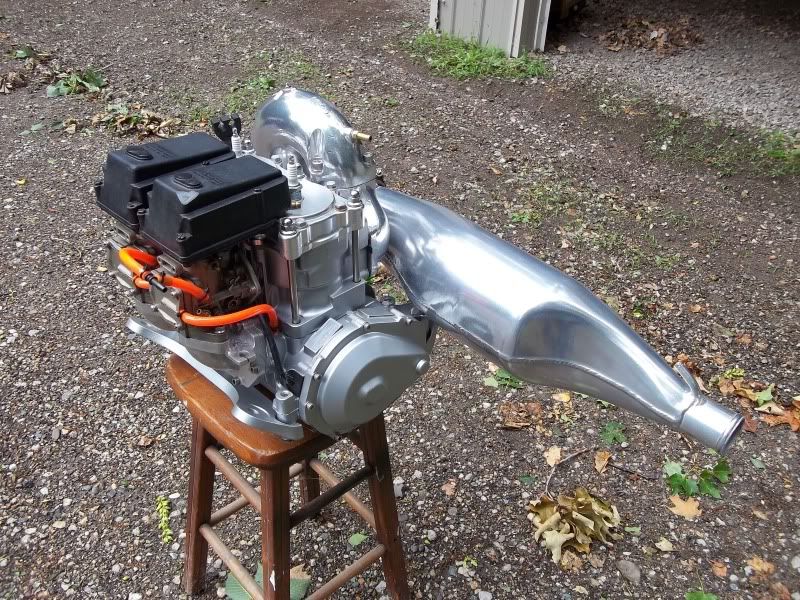

Before school I buttoned up my motor..

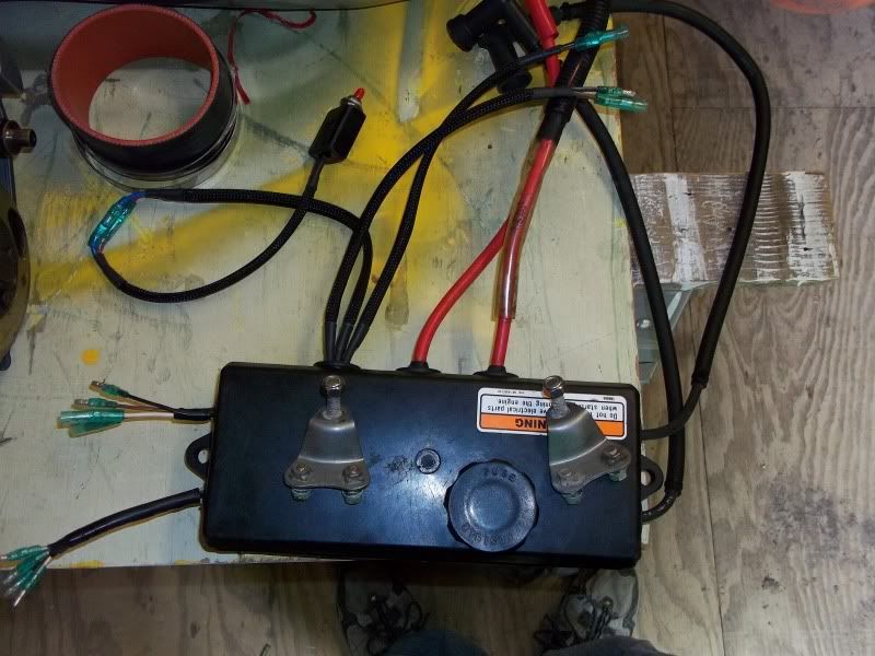

And assembled my ebox, quick disconnects all around and installed the OCD Tidy Bilge Harness. That thing is AWESOME! Ground and power are all connected inside the ebox so you don't have to run anything to the battery! That and the OCD Surf Armor will go on every other ski I build. Highly recommend it..
