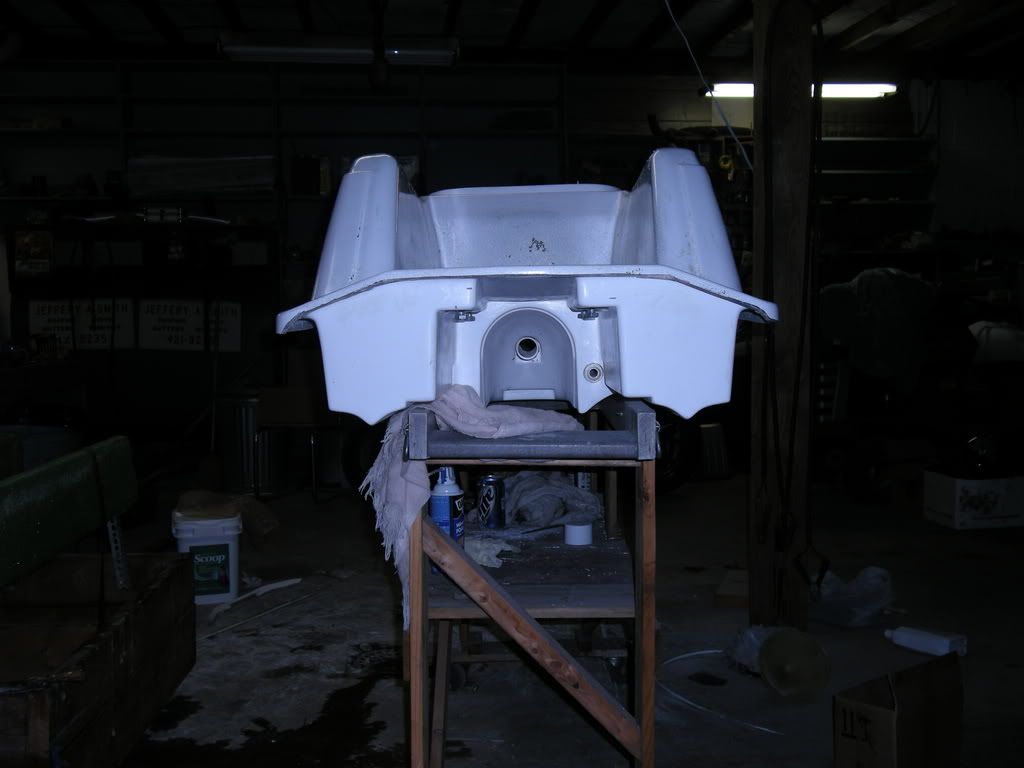

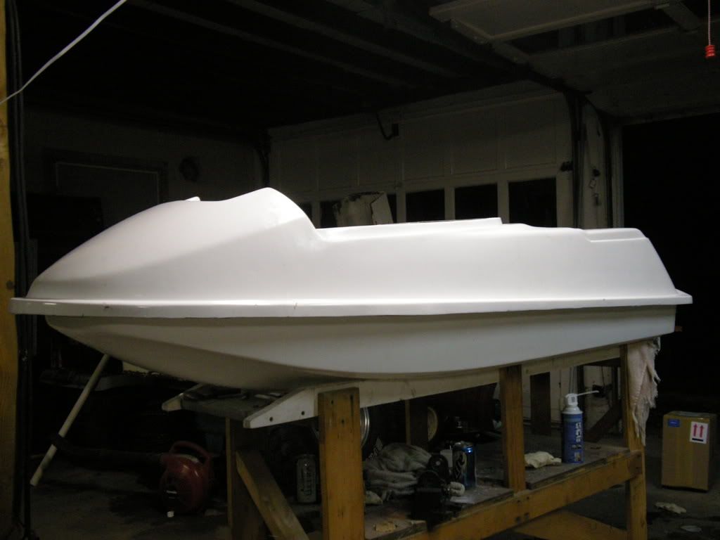

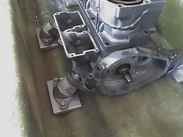

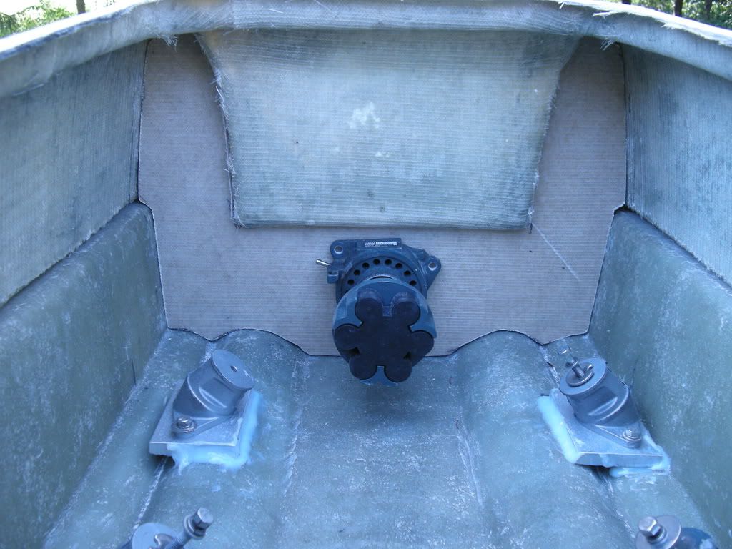

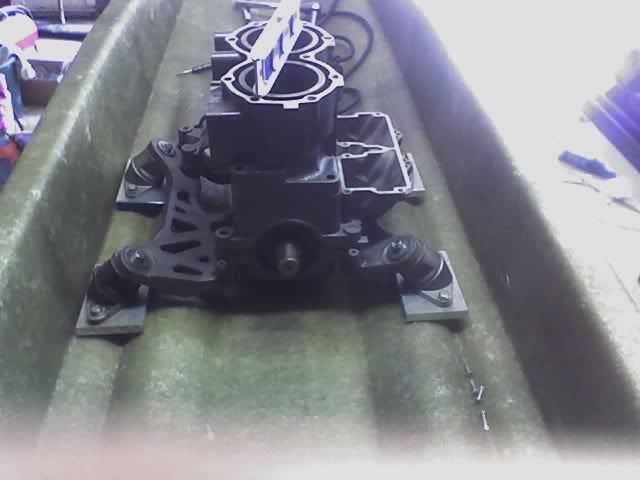

just pulled the hull out of the mold today i laid it up fri.i was unshure on what weight i was looking at getting i was thinking on the heavy side.when i was laying it up i was keeping the sides thinner thna the bottom just because i was planning on reinforcing the sides when the top was bonded on but it really doesnt need it i didnt realize the stregnth of s-glass.but i will do a layer of carbon just to be shure.the weight on a bathroom scale was 28lbs and rock solid i couldnt be happier.by the wknd i plan to have the mount and incerts all glassed in place.let me know what you think
