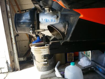

I can tell you my nozzle off a GP1200 is 5 degrees trimmed up and was 86.5 mm stock and was able to bore it out to 90.35 mm. A bore that large made it thin on the outer edge but it tapers thicker quickly.

Isn that the KDX pantydropper hull in that pic? :) Are you sure its a 5deg nozzle.
I would really like to know how to know/verify that its a 5deg nozzle other that messaure or visual.
yes, its to get 5deg static. I know i can get it by making a steering nozzle stop at 5 deg. But i really would like the 5deg exit nozzle.

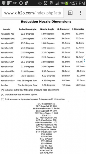

yes i do have that chart, but I'm missing the 65U(unless the 65V is the 65U) and 63M nozzle. Thats why i posted this thread. How do you like the KDX ?
