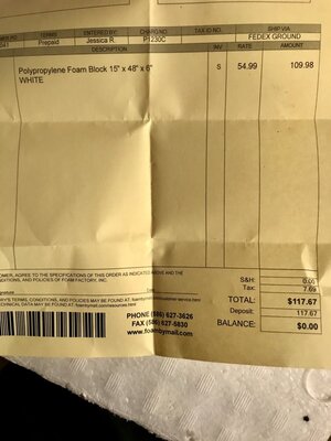

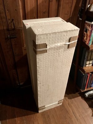

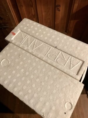

So it took me a while to find this stuff and a lot of phone calls. You would think google would bring up exactly what you are looking for, but we all know it’s not always that simple. I thought I would share some information due to the fact the only info I could find was 6+ years old and most of the links were 404’d. Anyways I just purchased 2 large blocks of EPP from a company called Foam Factory inc. they were fairly expensive but when it arrived today. Woah. This stuff is very dense. I immediately did a test to see if it would support my weight just standing on the blocks. I weigh about 210 and it didn’t even creak. I’ll update later to let everyone know how it cuts and how easy it is to work with when refoaming. It comes in Black or White and free shipping over $75... I bought a lot though cause I have a few skis and though it could be useful for many things.
https://www.thefoamfactory.com/closedcellfoam/polypropylene.html
9F1523A8-0F5A-4EF3-AFE6-967C832035B6.jpegE3A4CCC3-FA13-4104-9AC8-94C44199C297.jpeg8585D6D9-01A1-4ABB-AE9D-A8FCC5AD358B.jpeg
I was just warned not to use this stuff, as it will absorb water. Sucks for me but I guess I will find another use for this foam :confused: I did a lot of research though and I know that polypropylene foam is used for the OEM nose piece in front of the water box. Maybe this is a different compound?
I used this same exact stuff from the Foam Factory, and it most definitely does NOT absorb water... not sure who would have told you that...
