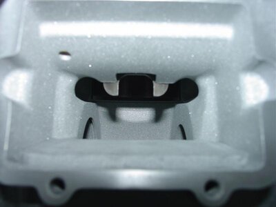

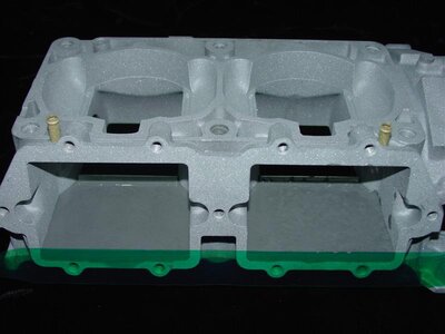

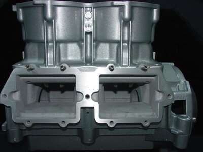

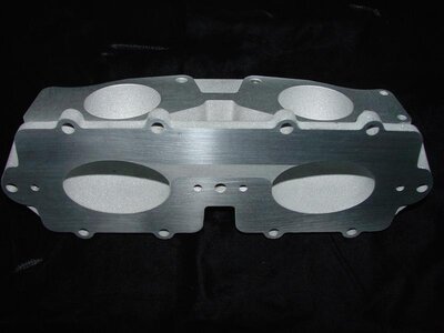

Building Devcon aluminum epoxy ramps in the reed cage finger area on the 62T cases increases the primary compression ratio and helps in getting the fuel mixture up the transfer ports quicker for increased throttle response.
Filling the intake manifold crossover with epoxy helps to promote an improved signal to the carbs for more precise tuning.
Here's a picture of both.

First 2 pics I get, the other 2 I do not.. what was changed?? And thank you for clarifying that...
