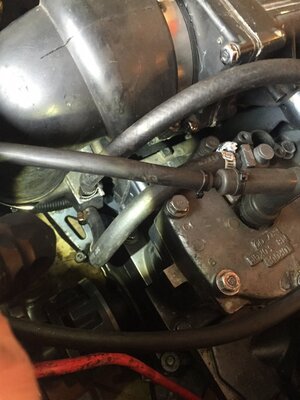

First time my driveline stripped only noise was motor. Second time it has barely stripped and you could hear the spline slipping.If it were worn slipping spines you'd think there would be a secondary symptom of noise as the splines slip past each other
Yup I pulled the motor today and swapped out the starter with a spare I had laying around. The battery was low so the engine wasn't turning over but at least the bendix engages the flywheel properly now. However, after charging up the battery all I hear now is the relay click when trying to start. I sure hope I didn't fry the new starter..The starter is no bueno. gear is stripped at tip . You need a total teardown and replace with minty used oem parts as needed, they are actually easy to find right here on the X it will save you money in the long run . Good luck
Didnt you pull the midshaft while the motor was out? looks like the seal has an issue in blownup picture then check splines,bearings etc.
