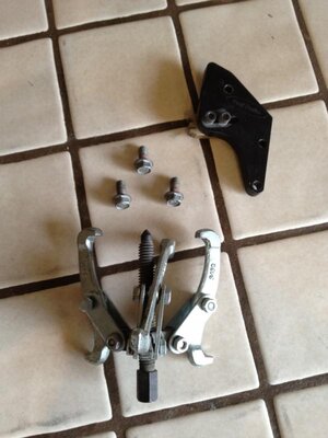

Who can tell me what tool should I buy to remove the Flywheel?
I got Cold Fusion's but that is to remove the Bolt.
I need the one to actually pull it out.
Thanks!

Benny, it is a small 3 prong puller that you can rent from autozone, don't know what the actual name is but it is fairly small

I use a puller. At the moment I have a lightened stock flywheel and just outside the flywheel bolt there's 3 threaded bolt holes in the flywheel. Install shouldered bolts in these holes to allow a 3 pronged puller to grab the shoulders. The center bolt on the puller presses on the flywheel bolt (flywheel bolt out to give about 1/8" gap between bolt and flywheel) This is a bit of a pain, but works very well.
Once you get it snug by hand, then use a wrench to get some good pressure on the puller bolt. I've found it works best to tap the puller bolt in line with the crank, with a smaller hammer. The flywheel normally pops loose after a few light hits.
I'll shoot ya a pm with my # if you want to call me up. My explanation sucked lol! I'd be more than happy to explain it to you over the phone.

Benny. Give me a ring bro. Here's a pic for you to check out. I'don't have a flywheel to show you with but... The 3 M8 1.25 bolts thread into the face of the flywheel a bit. That's what the terminator arms grab and the center bolt of terminator hand pushes against the flywheel bolt. So the bolt is pushing on the crank and the arms are pulling on the flywheel.
Watch for the woodruff key when the flywheel comes off. Sometimes they drop out. When reinstalling, the torque spec for the flywheel bolt is either 70, or 75 lbs.
