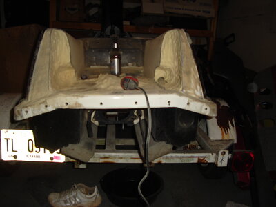

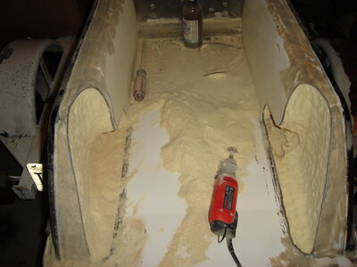

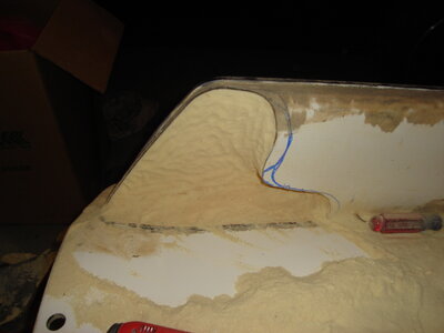

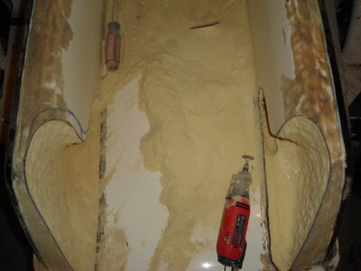

Did the other one and trimmed up the original before class today...Hobby Lobby was closed so I could not get the foam to shape the cup for the feet.

Lookin good man. The first one took me about 2 hours to shape then I made a template of it and the second took about 30 min. If you want to save some money on under padding you can buy rolls of low density closed cell EVA foam from camping stores for about $8. The stuff they sell at gander mountain is exactly the same as the HT stuff but costs a ton less and comes in pink and purple.

that is looking alot like a 24/7 foothold. Make sure you re-inforce the hell out of that tray area cause you sure did remove alot of supporting area from the tray.
