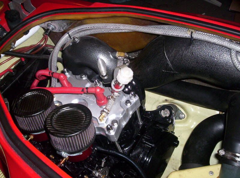

Anyone ever mock up or try this, forget about the tank for a minute, how does the chamber lay in there?
FL
Here's a good pic of a limited chamber in my blaster. I just don't see how it would clear the hull. It actually bends away from the motor if I'm not mistaken.

I'm going to find out over at Jetskidood's house soon, after seeing one in an X2 like it belonged there, my thought is it might work with an X2 tank in the SJ. They are about the same length, but not sure how the transition to the waterbox will go. I bet its not much different looking than a drypipe, just more fwd.
FL
You know, it might work if you rotated it toward the motor. You would just have to figure out how to mount it. I don't think the waterbox would be too much of a problem to connect.

:scared:We'll mock it up soon when he puts in his pipe.

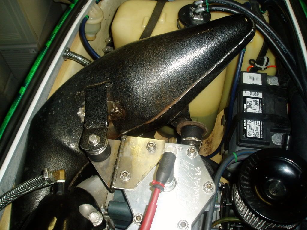

I have only heard of people mounting the B1 mod stainless chamber in SJs. I did not think it was possible to get the B1 limited chamber to fit into the hull. Here is a pic of the way I mounted a mod in the wife's SJ

It may be as simple as a gas tank change, but I will know for sure soon. If you have ever ridden a Blaster with one, they have a nice kick in the pants feel.
