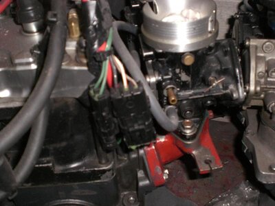

gm water proof connectors. works great i have my stator wires run with these connectors and my bilge. nothing but salt water. going on 3 years. makes motor swaps fast. i have all my spare motors all ready set up. just plug it in.
I have a couple of my connections set up with GM style connectors as well(also used in Seadoos which is where I recycled mine from). Just gotta buy some of the terminals.
Put some dialectic grease in them and they are pretty well bulletproof.
baldwin ny
i got all of mine from happy terminal .com. right weather pack. i would get a pic of my boat all set up but it all covered up. to dam cold to mess with it now. lol going to daytona ? it will be there. 1990 stock stickers nose mashed off with turf hanging off it. lol

i love it i did a post on the ele box for the starter wire. i never have to pull the ele box to swap out motors. nothing like a big waves weekend and having a motor blow up. 15 mins i am running again. (i have complete setups ready to go exhaust manifold,head pipe and all.)
i also do motor mounts every other year so i pull the motor out all the time.
its such a pain in the ass to get a yamaha ele box sealed up good. i hate to mess with it to much.this way i dont have to.
