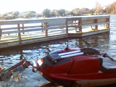

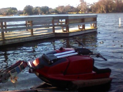

Cold as hell. I ended up wearing my shorts, shorty wetsuit, an my full surf wetsuit, gloves, vest, shoes, helmet.... still cold.
Anyway, it rode CRAZY. The nose is Waaay more responsive than it used to be, (and it was really responsive already) The downside.... from what I can tell racing may be a bit harder... the pump really comes out of the water on turns now. May have to change my riding style a lot.
The down side... I definately should not have changed with the jetting. Because It ran so horrible I only got a few minutes in. I changed the jetting back to where I thought it was and it only got worse... to the point where I thought I lost compression. Luckily I did not, and I guess I just fouled my plugs.
Oh well. More tuning for next time. my mini fs-1 on the trailer.
Edit...
Holy :):):):), I just took a shower. weaing double wetsuits was so tight that A full hour and half later I still have red imprints on my skin from the wet suit seams. Impressive.

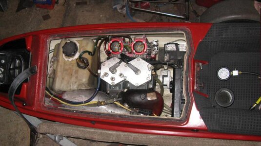

Damnit. Just figured out why the ski ran like :):):):). There is a pin hole crack where in my chamber from where it used to vibrate on the flywheel cover and then I dented it in. So it was slightly leaking exhaust into the hull... but not enough for me to notice. Makes sense why it ran great on the trailer and tuning with the hood off.
Guess I finally will get use out of those Alumaflux rods.

Well... You know Ive had this problem before... with such a compact fit in the nose, the waterbox will blow off easy, So I figured thats what happened. But when I took the hood off it didnt billow out with smoke. I check all the couplers and it was fine.... What I realized is I was wearing sun glasses, and there was a tiney bit of smoke, I just didnt notice it. The faster I rode, the harder the leak would leak, and the worse it ran. but if I slowed down it would clear up a little. Either way.... I gotta take the damn gas tank, waterbox and chamber out again now... Sigh. Ive done it enough though so Ive gotten it down to a 20 minute procedure... but it used to take me about an hour.
What can I say... its a tight fit. Hell... nothing holds the gas tank in but a press fit. haha
