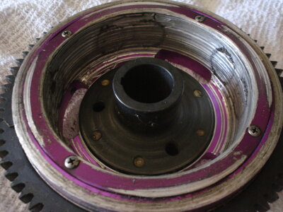

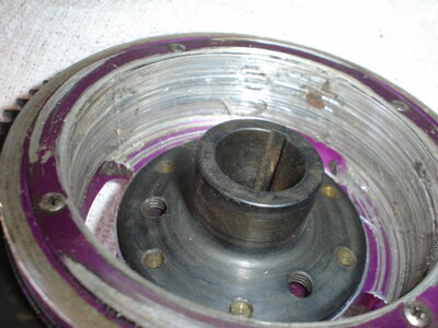

i wouldnt worry about it,im sure it will be fine.....
