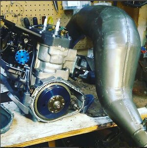

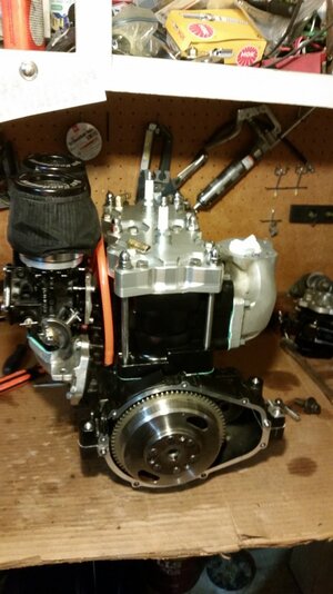

After neglecting her all summer. I finally gave her some updates:
Old Coffman dry pipe. I added a sprayer with 120 low jet after the coupler. (already a spot there so trying it first.)
62T cases
61x 83mm @Nuklear6 CPT ported cylinder
@#ZERO Flywheel
MSD enhancer
dual freshly rebuilt 38's (no choke, 1 screen)
75P
140H
34psi pop off (really not sure where to start here, have read from keeping it at the stock 55psi to as low as 24psi)
New midshaft, pump, bearings, etc
Trying a solas 14-18 impeller until I get my Solas 13/15(similar to hooker 9/15) back from impros.
