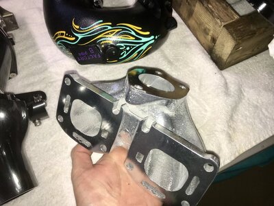

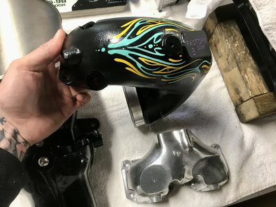

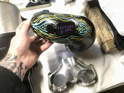

The flange on my fx-1 manifold is 9.5mm and the one on my blaster is 12mm.Mill the manifold some. Think i read recently that blaster manifolds were actually thinner at the manifold to exhaust Port area..

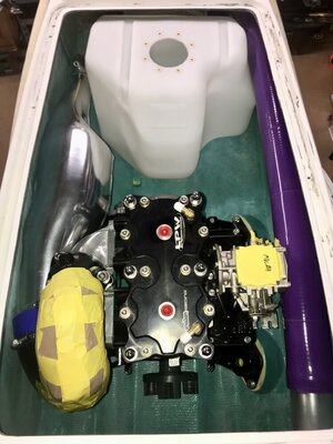

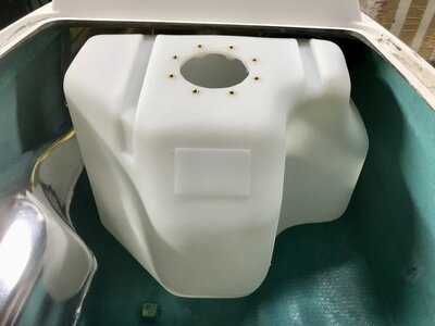

Who makes that tank? Looking spiffy!

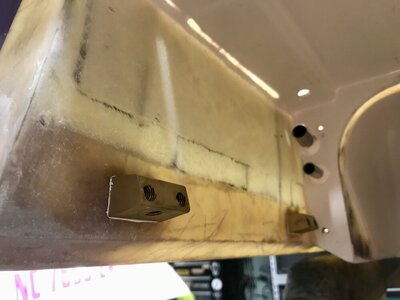

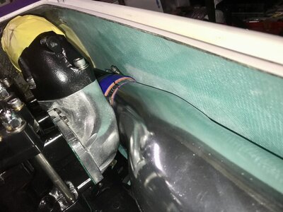

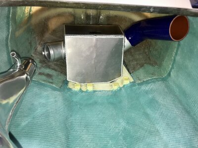

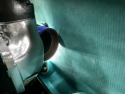

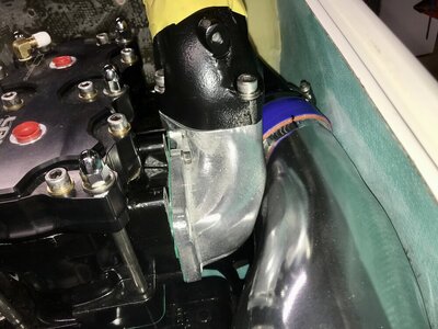

Mount some ufo mounts and you can attach zip ties to pull the hose against the side to gain clearance.I was able to get some more test fitting done… it’s looking pretty good!!!
View attachment 422516View attachment 422517View attachment 422518View attachment 422519

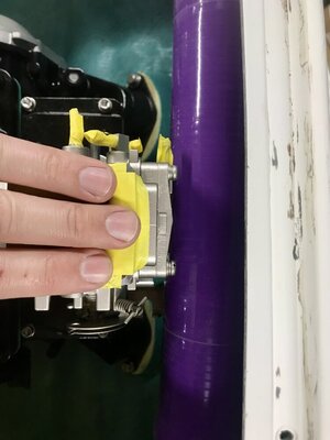

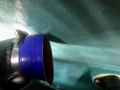

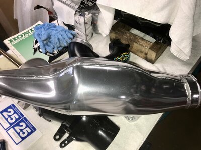

Some minor clearance issues with the exhaust hose and carb, not a big deal though…
View attachment 422520View attachment 422521View attachment 422522
