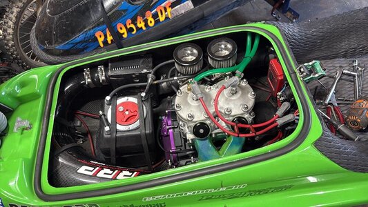

Time to order a JM water box. So tired of my engine being full of lake water every f’ing time I stop the ski or put it on the stand. Rrp waterbox is about to obliterate my second engine.
DylanS
Gorilla Smasher
Lebanon Pa
Long story short
Engine got obliterated, again, by the rrp waterbox.
I rebuilt it, changed to a pfp waterbox, and along the lines updated my MSD setup and wiring to be a little prettier and use duetsch connectors for quick troubleshooting.
Changed from a thrust fill to a summit fill with a much bigger opening and easily sourced gaskets/gasket pattern. Bought some 1/4” snowmobile fittings and bungs to put my own fuel line setup together.
Over tightened my gasket on the fuel fill like a goober, ended up doubling up and lightening the torque and good to go.
Last issue to work on is brackets for the tank straps so they don’t cover the fill and sometime in the future a bottom deck overhaul.
Ski has grown on me majorly and is a ton of fun although for someone of my skill level a little challenging to flat water flip but surely doable for a pro.
Super super reliable. Have had one issue and it was a broken pickup wire in about 20 gallons of fuel with me constantly slamming it upside down and left to right.
