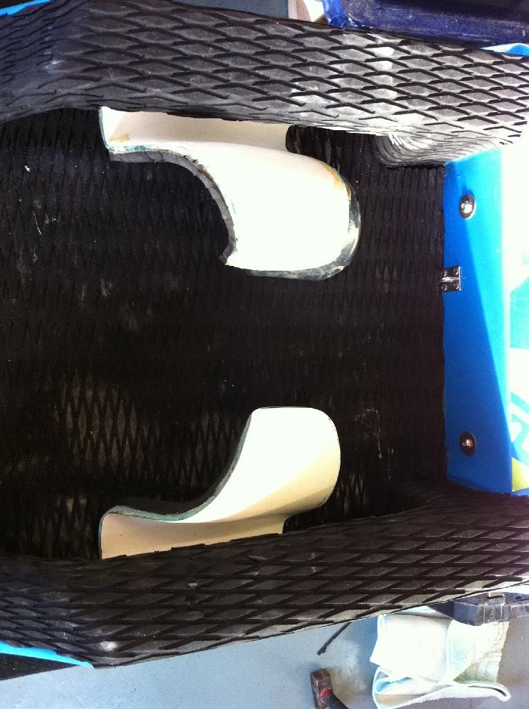

Heres the footholds from behind. Theres quite a lot of adjustment on the footholds forwards and backwards depending on where you drill the mounting holes, or you can loosen the brackets and slide them a inch or two.

Does it not feel like your feet are to close and straight together mate. But your setup is really looking sweet get flipping

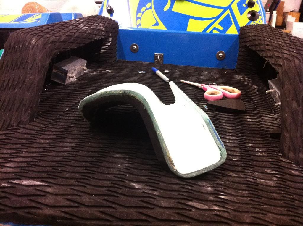

Il take some pics tomorrow of the footholds mate, I've just put the under padding on them so guna test them the turf over the top if there ok
Whats with the big aluminum block between the bracket plate and the holds? Im running tonys brackets with our adjustable holds. We run bolts from the back side of the bracket right into the hold. That looks like your feet will be very close to each other.

It's a 40mm spacer, I'm going to change the block to a 20mm to get the holds a little wider, I have to do this because of the under padding it means the holds won't fit in the buckets. I believe tigercraft are making new holds so in going to look into getting them for the future.

yea those foot holds are really close together..
...thatll not only make stability a little tricky but you tray area is really restricted

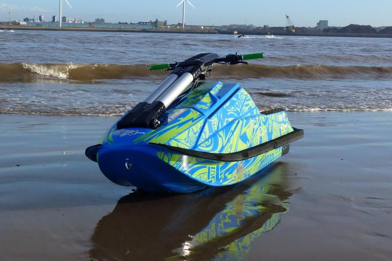

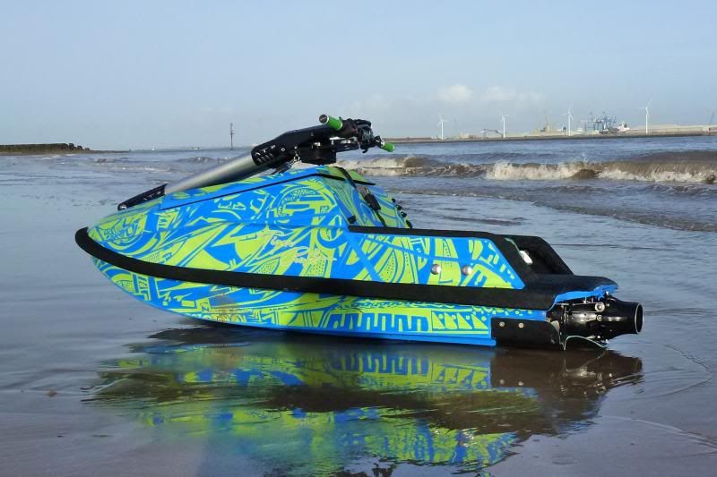

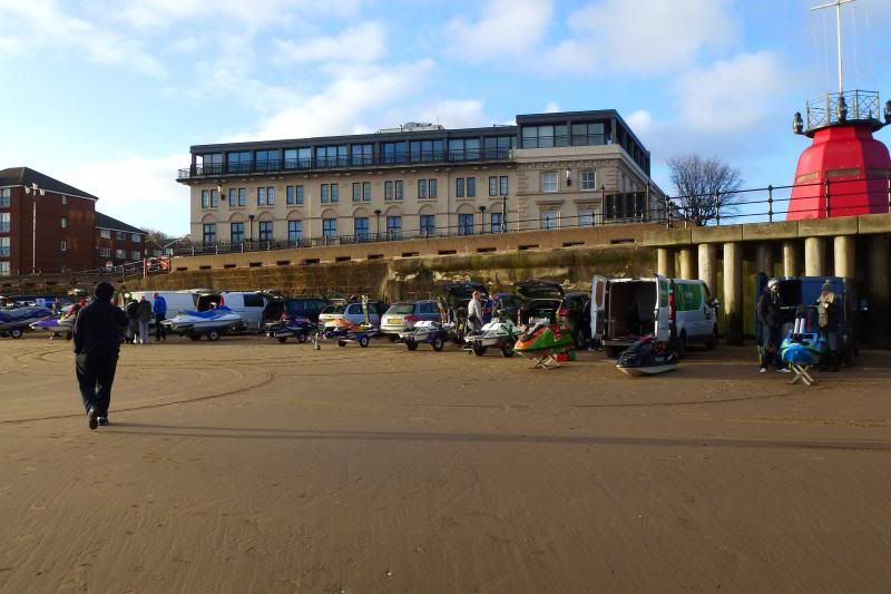

So today there was the annual N&C Jetski Xmas run in the river Mersy, Liverpool. A good turn out for over here, heres a few pics of the finished ski and a mate flipping it first try. The ski rode really nice but is not fully set up, running stock ignition, and needs pole and ride plate cutting down
