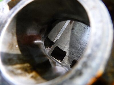

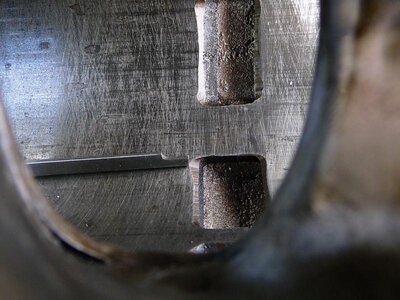

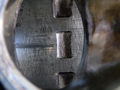

I was actually considering using the CNH (Case New Holland) anaerobic flange sealant. When I worked with the Case dealer we used it quite often to seal hydraulic transmissions and that stuff worked amazingly well. It not only withstood the temperatures, but it cured in minutes once torqued and held up against any pressure in the trannys. One of my thoughts for this were also to get a little bit more compression out of it without milling the head. Another thing I was considering, and again based off of info found on these sites...was to only clean up the transfer port heights. I measured them all and they vary about one mm in height both in casting and to where the chamfers are ground at their highest. Some have poor surface matching to the cylinder ports as well. What I copied into a text file from the postings was to flatten the roof of each port and I would also like to balance out the chamfer heights too. My understanding would be to make them look like this: --- instead of on an angle like this: \
Does this suggestion sound right? The ports will not be higher than stock, but more internally open only at the roof tops, and equal in the highest stock height. The center port on both cylinders is about 3mm lower than the rest and the casting has a very sloped back wall leading toward the top of the port, similar to the second diagram above. I don't think those ones should be cleaned up because of their height and shape being almost identical on both cyls. With how they look, they make me think that they are directly related to the intake manifold ports. Any thoughts about this?
Here's a couple of pics regarding the chamfer heights and difference between the center ports and the rest.

Don't worry so much about the port chamfering difference. Cleaning up the ports and matching the sleeve with the cylinder casting will help. You will get an increase in compression by removing the gasket but that's about it. Just do it and see what happens. Don't worry aboiut the timing advance you have now. Way back when I ran a 650 in my X2 I had mine set about 5 or more mm. Can't remember what advance it was exactly but I remember the seperation in the lines.
dfw
The big problem with a 650 is in the fact they have to be tuned right at the edge of meltdown in order to make good power. Anyhow, you taking on a very expensive and time consuming task.
Thank you very much guys, I really appreciate the good tech info. I'll set the timing back to stock and just port match the transfers. The exhaust ports looked like they were stock when I first polished them but when I measured them last weekend I found that they were about 72% of the bore. I'm guessing someone has already been in there and opened them up. I can't thank all of you enough though for mentioning just how much is involved with one change here or there. I'm going to get it all back together this week then and hopefully get out for a test run this weekend :fingersx:
