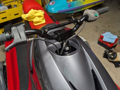

Got the UMI in
way more of a pain than I was bargaining for on an afternoon job, oh well. Still kinda tight, guess a cables in my future.
Didn't have any grommets on hand, future me problem. Also probably should have shmoo'd the UMI on, another future me problem

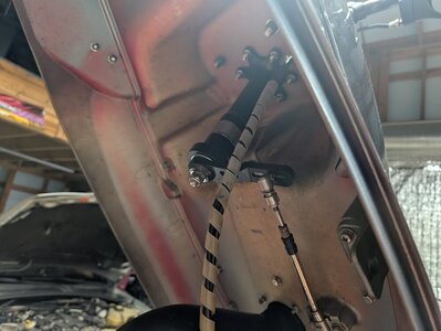

I'd like to get the extra throw out of the steering, but seems like it binds up on the nozzle, end link out the back if I scoot it over that far. Need to play with it with a clear head

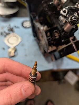

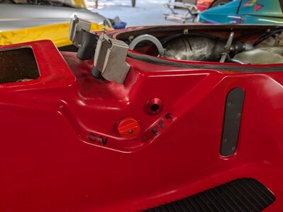

Went to rebuild carbs as it idled like garbage as was a pain to get past idle. Took the carbs off and some dummy did this.
Go figure. Carbs were otherwise immaculate despite being salty crap on the outside, stripped screws on the top. Got some fresh carbs from @yamahaulass thanks again man. Came in clutch.

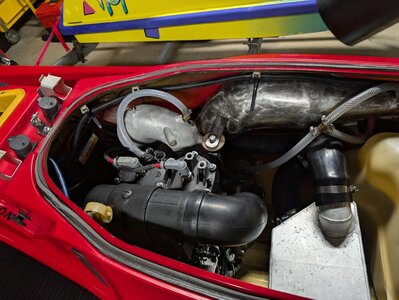

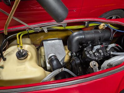

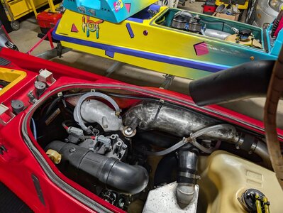

So this things kicking my ass! It's got some weird intermittent issue once I got it hot and wet in the hull. Feels like it's leaning out, but there's zero indication of that.
All we've touched is carbs, pulled them back off. All looks kosher.
Went through the unit chasing phantoms. Stock flywheel.. no water in there. Stock electronics... No water in there either.

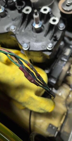

So. There is this. I'm going to address this. Hoping it's my problem.
Stator wires are a vinyl taped gumbigambi schmoo mess. So previously they were wrapped over top of the intake. I threw them to the side of the hull. Now it just sits in the bottom. I'm HOPING this wiring is junk and is just shorting out when it's soaked in water. Which would make sense it acts worse in right turns.
Id say you probably found your issue. Id cut that off and install a duetch connector that way you can remove the ebox separate from the engine and vise versa. Even if that doesn't fix your issue, it should definitely be addressed. Your main ground goes to the stator from the ebox so any shorting or corrosion there can cause all kinds of strange issues especially if you ride in any salt water.

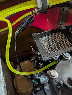

Plumbed in a bilge
Redid the stator wiring with weatherpacks (I'm floored this wasn't the issue)
Went down to 3/16 tygon lines the 1/4 didn't really fit well. Little better routing this time too.
