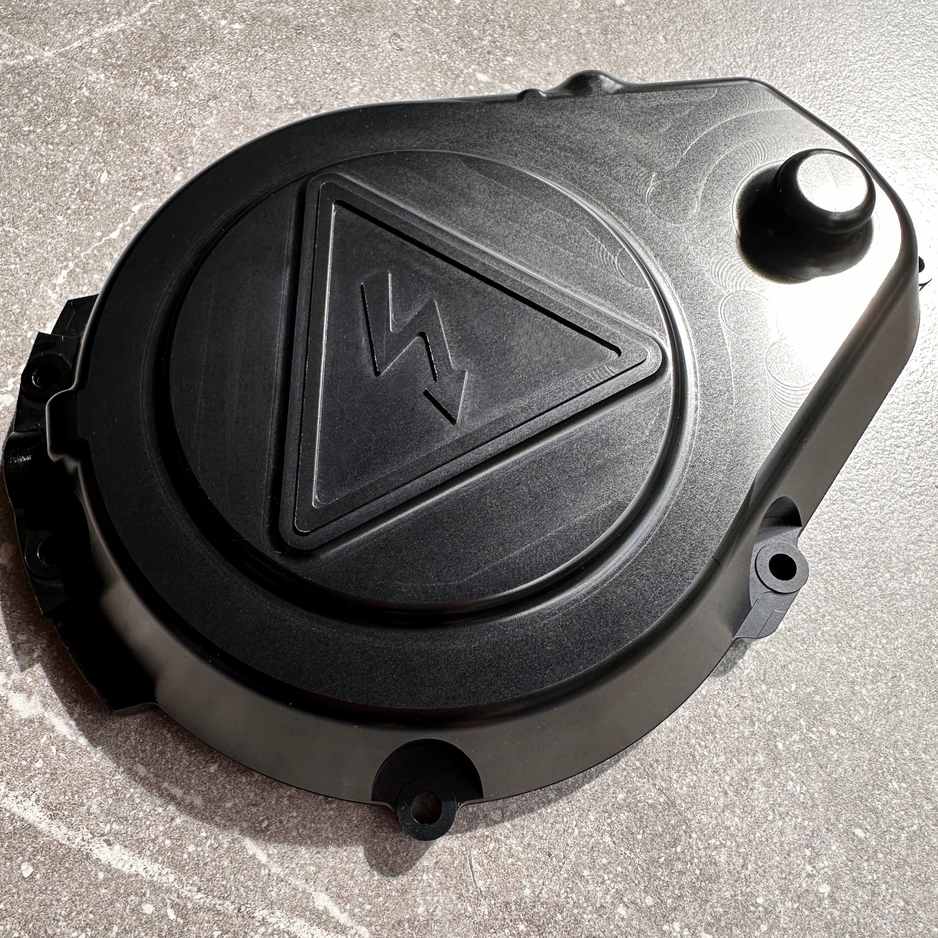

Not that i know of but damn you can run this and have twice the charging if you like. Awesome
