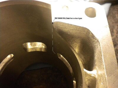

The old ADA Cylender and the new 89mm cyl are TOTALLY different. I have BOTH sitting in the garage and the port sizes in the cylender and the sleaves are WAY different. And the old style was not bad if it was ported propperly BTW. But it was not much different then a stock cylender when they get to your door from ADA. Unlike the new 89mm set up.
If you want no expense spared power then a flattop from Desa or a Chuckey motor is prolly better for you. If you want REAL NICE POWER at a right now budget as well as down the road budget, I think the old SeaDoo pistons are the way to go. Plentiful and cheap and LOTS of bores ahead too.
