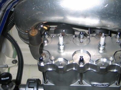

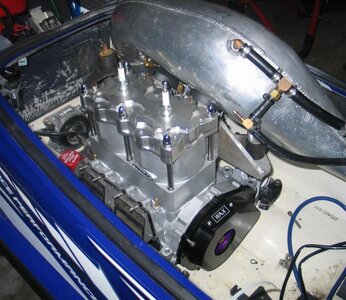

well working on the ski some more
Working on the exhaust mounts
Almost there , this is one r&d exhaust that will not fall off like they are known for
Thanks to Dawson for helping me on the bracket
We had made a rave link but after fitting the exhaust it only needed a small tap and the std caps went under

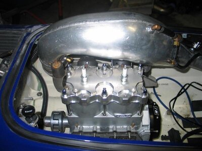

Well the exhaust is pretty much finished now and looking great
Thanks to brad and bobby for there help in getting this finished
Since the stroker engine sits higher the exhaust required modification and i also added some substantial brackets to stop the pipe coming apart as R&D pipes are known for

wax- i had nothing but trouble with my r&d falling apart- we built a mount similar to yours but using the stock pipe mount position farther forward with 2 lord mounts and also we went to a semi truck shop and bought peterbuilt turbo coupler and hose clamps to use in place of the r&d stuff-- you could swing the whole boat around by the pipe with a crane and it would not move-- worked great until the chamber started splitting on the welds-- probably because it was mounted too ridged--GOD DAMMIT-- oh well-- good luck with your awesome build.
waxhead
wannabe backflipper
gold coast
damn thats not sounding good is it
well i will just have to try and see what i can get away with
they make great power , but reliabilty lets them down
