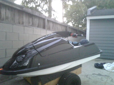

1 and done
used a 3m removal wheel took about an hour. now i just have to figure out az number location and type.
