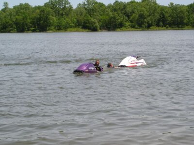

Made for some really tense moments. I was on my white ski and my cousin on my orange ski. We were at the 9mm of lake of the ozarks (between toad cove and the golf course). I ran out of fuel. Thankfully my cousin saw me and went and got my dad who was in our 23' Mariah. After floating for 10 minutes I turned the bilge pump on and got all the water out, or so I thought. Turned out the bilge pump failed. Needless to say, after a loooong tow back to our cabin in the lake of the ozarks chop, I spent the rest of the afternoon getting my ski started again.

oxnard111 said:
Seems like when towing a stand up, the shorter the rope for towing helps keep the nose up, thus less water in the engine compartment. Just me $.02
This last time we had success with around 10ft behind the boat and me riding the ski on my knees. The ski was dive bombing if I wasnt sitting on the back of it, lol.
