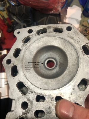

The reason I cc'd just the head was to see if someone else had cc'd a stock head. This way we could compare numbers to determine if the head I have was cut. I would like to retain stock compression. I am super anal retentive about engine building, so I need to know this. The head shown in the first post of this thread measures at 36cc, both front and rear dome. I tried to measure the installed cylinder volume with the piston at TDC. But because of the feature inside the dome around the spark plug on the 64U head casting, I am not certain I got all the air out the cylinder. (see pic at bottom) I tried my best and tilted the engine repeatedly in an effort to get all the air out, and several large bubbles did surface. Although I am still not confident my number is perfect, but it is probably "close". I measured 32.5cc chamber volume. This is with the piston at TDC and the fluid level in the engine to the bottom thread of the spark plug hole, while making every attempt to remove air trapped in the head. Piston size is 80.25mm, stock base gasket, stock head gasket. I did not yet measure squish, and will do so using the crushed solder method.

Haven't cc'd a stock superjet head (64u) but yours appears uncut. The ridge around the perimeter of the dome is normally gone after it's been cut. Stock should be around 33cc. Gasket will add around 7cc. I have an old WC head with interchangeable domes that still uses a gasket. Their chart read something like this. 27cc=190psi 29cc=185psi 30cc=170psi

I would agree with hornedogg79, visually you can be pretty sure it's not modified, but I can understand wanting to actually measure and know.

Observed head volume is 36cc
Gasket Volume (unfortunately I didn't measure the diameter of the metal fire ring in the gasket, so let's assume 81.5mm dia, but I did measure the thickness which was .060" uninstalled. So let's also assume a .050" (1.27mm) crushed thickness so that's 6.63cc for gasket volume = (((8.15cm/2)^2) x 3.14159 x .127cm).
Head volume + gasket thickness - piston crown volume = chamber volume
36cc + 6.63cc = 42.6cc.
My observed combustion volume was 32.5cc, if anything, this is probably a little on the low side because of air trapped in head. (read post #6).
So by my math, the piston crown occupies roughly 10cc. Does this sound right?

I only mentioned the westcoast head because it uses the stock gasket. Oring head psi charts will be completely different. With oring heads the target squish is usually .045. Stock gasket is .052 so it would require some work to make your squish too tight with a stock head. Apparently you can cut .045 off a stock head, redo the squish angle and still have a reliable pump gas ski. I'm almost certain your head is stock with that lip still showing on the edge of the dome. I'm not a motor builder though. Just a jetski nerd.

Stock 14’ SJ head. I’ve done about 10. They all are around 34 +/-.3

Then there must be differences in the 64U castings. Or the more obvious, is are the head volumes different between the front and the rear. You appear to have done the front, and I appear to have done the rear. I measured this before, and I was pretty sure I got the same volume from both. I'll recheck.
