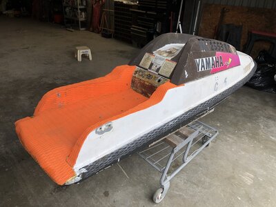

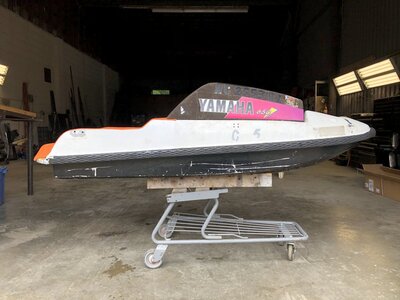

This is how the ski looked the day i got it. 2 weeks ago. It was pretty "roached"

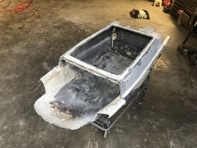

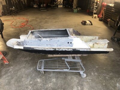

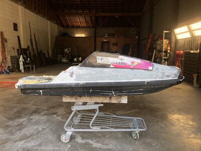

Got right to doing a rough cut on the hood and nose and cutting the tray open just to see what i was working with.
After a couple of days of looking at the poorly done and excessivley thick fiberglass job that had previously been done on the front i said screw it and did away with all off it. At this point i was feeling pretty overwhelmed for sure.

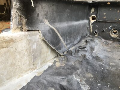

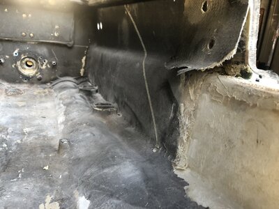

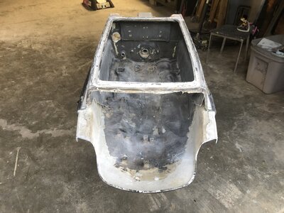

In the next 2 pictures you can see that somebody had also "reinforced" the sides of the engine bay but its now delaminating. Im going to try my best to pull all that reinforcement out and then redo it later with epoxy and 1208 once the nose is redone.
