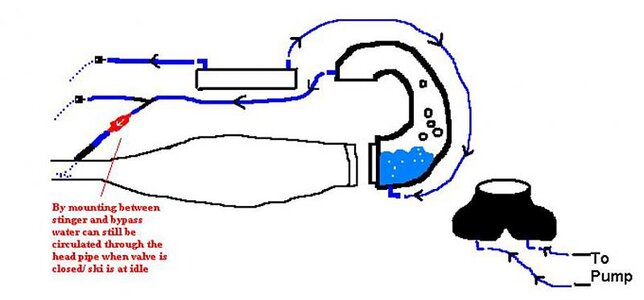

OK-I traded the type 4 for a B mod chamber pipe-searched the threads and found water line routing for dual cooling-and a heated debate about it-but-
single cooling w/ADA girdled head and B pipe and stk 62T/61X 701 engine
IS THIS RIGHT?
1-cooling line in to bottom of exhaust manifold
2-bottom of head pipe to back 90deg elbow on rear of cylinder head
3-top of head pipe to pisser w/ 'T' to stinger on chamber
4-front 90deg elbow on front of cylinder head to 2nd pisser
Is this right? THANK U GUYS 4 YOUR PATIENCE!!!!!!!!!!!!!!!!!!!!!!
I promise I am keeping notes now so I don't have to ding dong u guys all the time.
IS THIS RIGHT?
