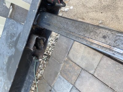

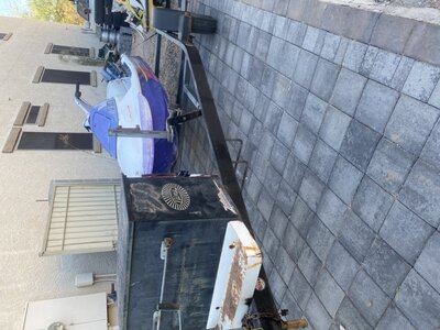

I am converting a Zieman double trailer, just recently picked up this with two wr3s on them for $1000. The skis were running, a 650, and a 701. Good donor skis and about what I like to pay in AZ for this deal. This is my second time getting this identical set for $1000 or less!

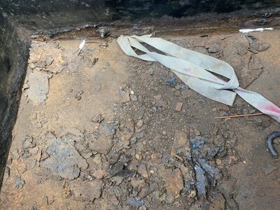

Trailer is a 1996 has the title and has a ton of rust! Barely made it back to Phoenix from quartzite but none the less I needed to move the skis around a bit so that had to get handled quick!
2639DCF9-40DF-471F-BC8E-AA1F0D9A4775.jpeg6E0ED536-9C30-416E-B7EC-94FB38E4A764.jpeg8E155C47-B97A-401B-92FA-171CA22CF9AC.jpeg9EBF8174-77BF-4FE4-8556-EC8E86B0ED70.jpeg61A06BF2-03FB-4392-967F-F1AAF06A164C.jpegE0FC4058-0F0E-4DE8-95B0-9C7F18CCAA41.jpeg172DBF32-C785-4BD7-B721-F1EEF4C44539.jpegEB3E8941-3811-4C23-BB21-0FD29534C7BF.jpeg701B3DEE-1464-4F53-92FD-17D45E94B977.jpeg

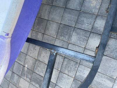

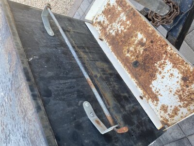

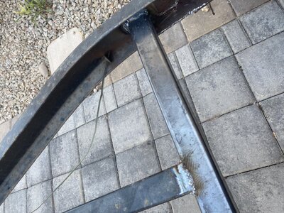

Here are the rusty bars I had to cut out, the back cross support and the front cross support thats attaches to the blue stop mount location.
Plans so far are 3 skis in the back, superjet bunk setup on the outsides and fx1 bun setups inside. Once my new hull gets here that will be the 4th ski mounted in front of the 3 on the rear.95D3B5A5-7E9E-4D85-BF39-68E057F4BEAC.jpegE6A79FD3-54D6-48BB-8410-F61B809C3315.jpeg33882B35-DB60-4ABA-BE11-E0819273CE63.jpeg

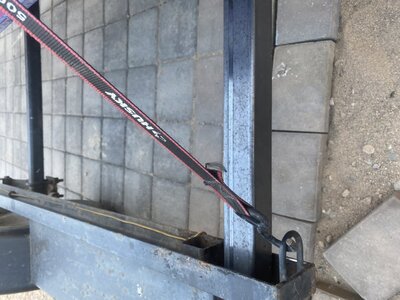

Not a very good pic but you can kind of see how I built up the ski racks on the side so I could fit my blaster in the middle when I need to.
Sent from my SM-S767VL using Tapatalk
I see, that’s some key info there, a lot of times you’d expect just raise the center ski up and thats only one ski that has to ride high and ride in the middle. Any reason you did the side skis on the elevation to clear the bond rail on the center ski specifically? That would make a lot of sense when towing one ski often but how does it ride with the two outside skis up high? These trailers are heavy enough I don’t foresee any issues getting up on one wheel regardless but just wondering why not raise the center ski a tad to clear a standups bond line being they have a “more shallow” bottom deck typically?
To be honest the thought of raising the center ski didnt cross my mind. Lol.
Ive been using the trailer off and on for quite a few years with no issues....one ski in the middle or one ski on one side. Originally the side were a few inches taller but didn't need to be so I cut them down a couple inches.
