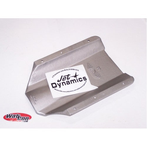

Get rid of that short rideplate unless you ride nothing but surf. Shorter pole is nice but that's not your problem. That plate you are looking at is no better than stock and stock is useless for your size and weight. I had an extended plate and it porpoised until I pulled the drop nozzle. I put a worx dominator plate on there and it took the place of the drop nozzle for stopping porpoising. You won't be doing any backflips with a long plate, but barrelrolls yea

Agreed. While a short pole is good, it is not your issue. Your short plate is your problem. Going back to A stock plate will be a small upgrade. A longer aftermarket plate will help keep the nose down more, and with you being a bigger guy will really help.
I like the DD long Jet dynamics plates. We ahve them in stock here;
