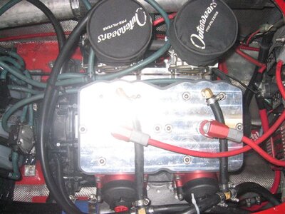

late night, teaser pic. Lukes motor's here but he doesn't have a ski so we are going to test in the octane friday and all weekend.

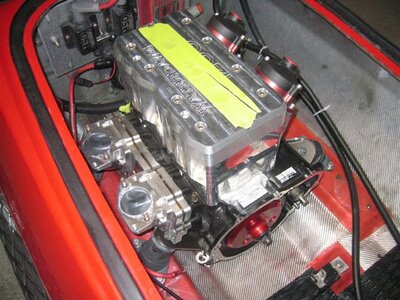

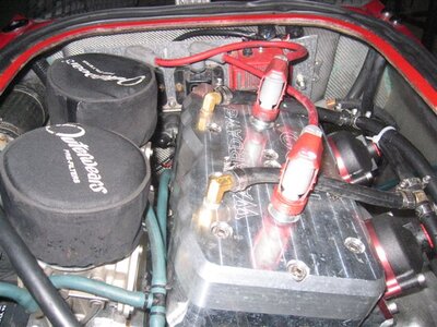

flash you need to do another build, i need some more inspiration. I have video of todays test but its boring, motor breaking in and we cant jump the ski until i get my beefy motor mounts in. Not to mention we were in our clothes and didnt want to get wet over lunch break.
Luke and I ended mounting the motor at a slant, just like my other setup. We had clearence problems using jeff's upright kit because my octane has a different motor mount area and thickness than sj's or rev's. I ran out of proper fittings on fuel lines so its a mess now, but i'll tidy it up later
