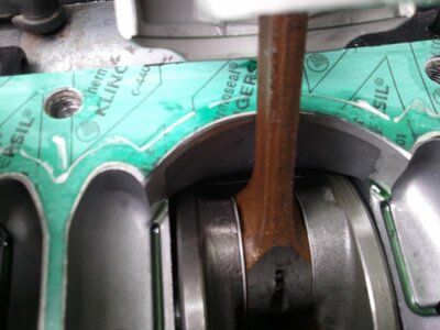

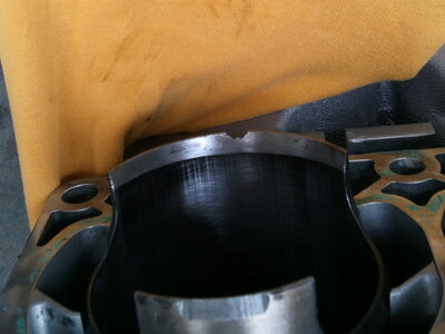

I removed the cylinder from the crank case to investigate and found a few things. First the (front piston) sleeve has a chunk out of the skirt. Then I found the connecting rod has a bunch of marks on it like the chunk had been bouncing around in the motor. Also there are marks in the bottom of the crank case from the same thing. I'm assuming that the motor was rebuilt because of this failure. The seller has not got back to me yet.
I'm guessing the piece of skirt damaged the crank itself or crank bearings and this is the vibration I'm feeling. Am I correct?
Can the sleeve be used still?
Can I have the crank rebuilt?
Any suggestions for what steps to take in getting this motor back to working order?
