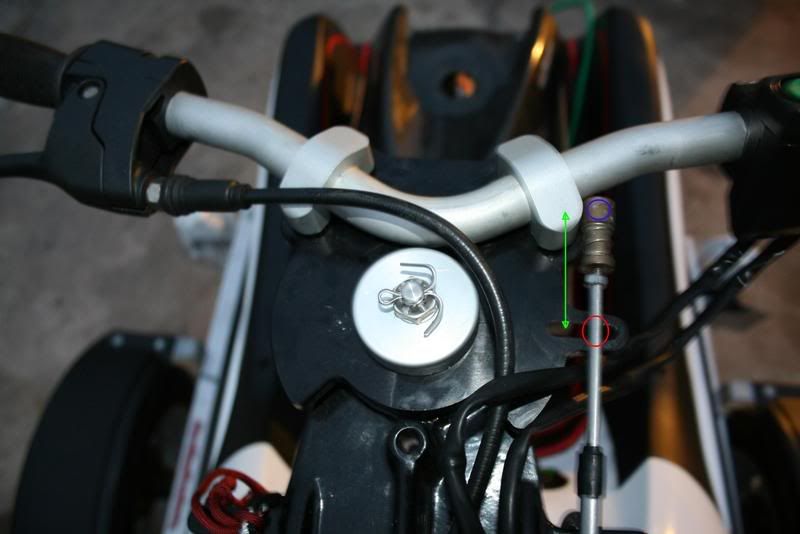

duh...
you cant on an X pole. its unreachable and fully enclosed.
I have done a UMI pole and know there is a relocation bracket.
I am asking for advice on this Xmetal pole!
I used a 750sxi cable it's shorter on the steering end worked great .You have to shorten it a little and counter sink the end link .The adapter from xmetal sucks it will work lose and bind up.there are some pics in my build. (post 38 & 39)
