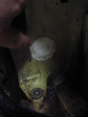

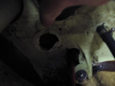

Super Jet Why are these here?
Whys are these here? What are they? I'm guessing the one thats broken through needs to be patched back up

I am pretty sure that is where they fill the backend with foam. They put that wonderful little sticker over the hole. Hit it with some 5200, but you can be sure to have some waterlogged foam.
chad
I pretty much love beer
I think your asking about the part with the screw in it... its there to hold the two halves together during assembly... I usually grind mine completely off...
Edit..... I. Zoomed and saw your were talking about the foam fill... 5200 or glass over it

Had a buddy that I believed had wet foam. Ski felt all lop-sided when turning. We drilled a few small holes at the very end of the ski bottom and lifted the nose up over night. Sure enough the floor was wet the next morning. If it would have been dry, just 5200 the holes and go ride. We defoamed/refoamed through the footholds.
