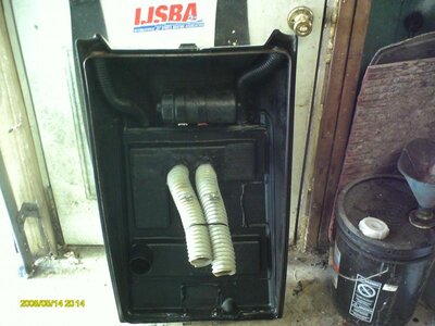

seats this is my hood on my sn. i have ben using this hood for about 8 or so years this way. it works pretty good keeps most of the water out. i do have a pump and a versa plug in my boat also. the 2 hoses in the front are from a raider mounts and all. the back 2 are shopvac hoses. the topside of the hood is stock. i cut little half moons in the rear of the hood to let the water out.
I like the "modded" Kawasaki tool kit.
Do you normally run the pump when riding anyways?

Seat's this mod ryan did is the same one TanMan did I looked and could not find a pic to post. Thank's ryan.:cool2:

yes pump is on as soon as i get to the surf.(i have a 5 mile ride to get there)i am not doing back flips (yet lol) big stabs working on roles (landing on my head right now) its gets some water in it but not to bad. motor never misses a beat. pump runs a few mins after deep stabs. i had 2 pumps but didnt need the 2nd one. send me a hood i will do one for ya if you want.
